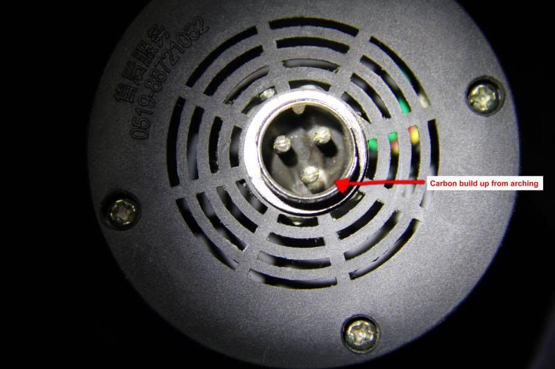

But there is one big fault in it and that is the connector used on the spindle, I was suspect of its voltage rating from day one and it turned out I was right. As you can see from the photos the centre pins were arching to the outer casing of the connector ( which is grounded by the cable braid ) casing carbon build up, with the end result causing my RCD to trip each time I started the spindle.
I have now replaced the connector and the spindle is working again
