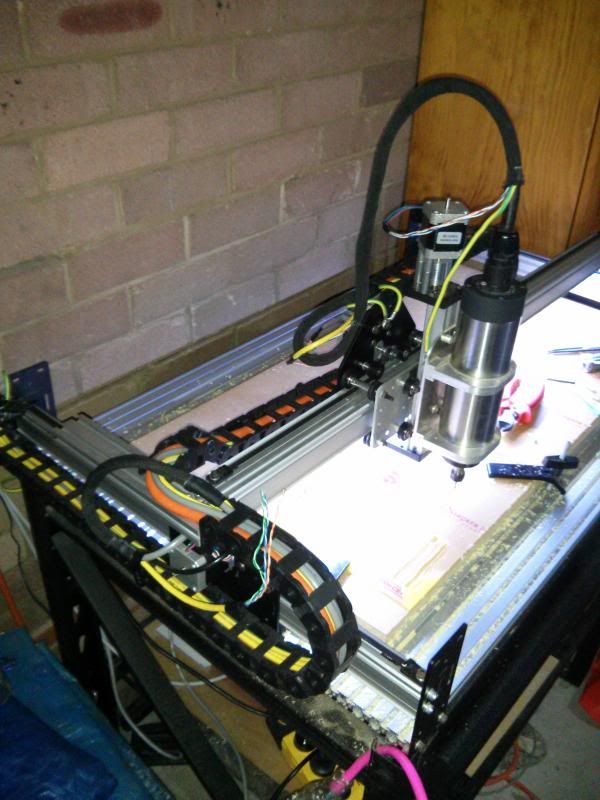

Re: Chinese Watercooled 1.5kw Spindle
I earthed the cable shield at the VFD into the earth terminal and ran a 6mm earth (its a over kill in size, but its what I had laying around) to the back of the spindle mount.
I ran the earth and spindle inside some sexy heat srink braid heat shrink braid
Thanks again forgottenCNC, the pictures are a big help. Depending on what mount I can locate for the spindle I might try the ground in the same way, looks like one of the best ways to go about it.
