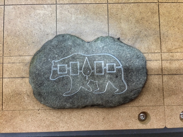

I laughed when I saw this thread. When I got my Shapeoko I asked my daughter what she wanted me to make for her. Her reply was I want a rock that says "Nothing is engraved in stone" on it. I hadn't gotten around to making her one but saw this and said what the heck. I am not a geologist but my daughter is a rock collector as well as being a smart aleck like her Dad so I dug through till I found one that looked like granite.
I didn't do any fancy leveling or anything like that so it's not perfect. This is a single flute 1/8" 60 degree carbide bit that I got off Amazon run at 10ipm, .005" per pass. I went too deep trying to make up for the flatness but it carved pretty easily at that slow speed and depth, no stress on the machine.
I have some beautiful black granite 12x12 tile I was going to try with my diamond bit but the Z axis just flexes too much. I may just try cutting like this. If your willing to sacrifice a bit to the granite I think you may be able to engrave it.

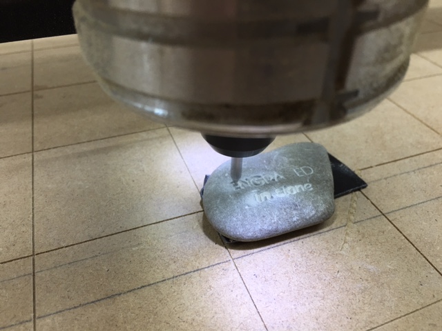

Daughter and I walked down to the creek today and pulled out some nice flat stones to try. I was trying to find some shale but this seems way harder than that. Same bit and I was able to carve another stone while the bit still looks ok.
