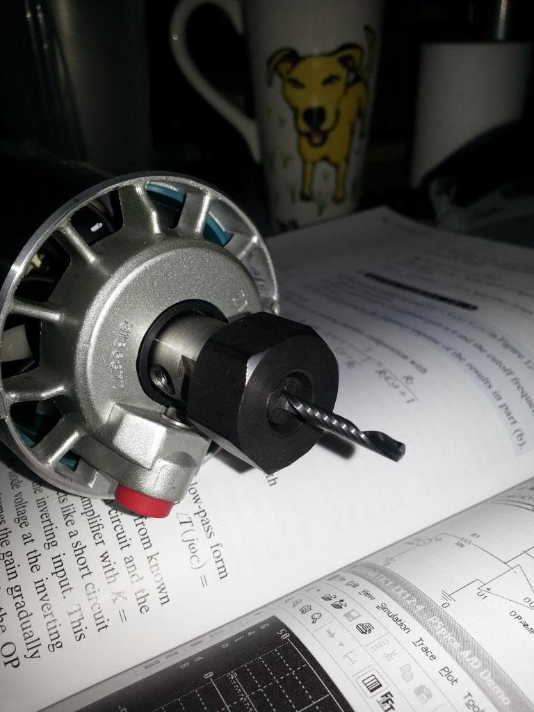

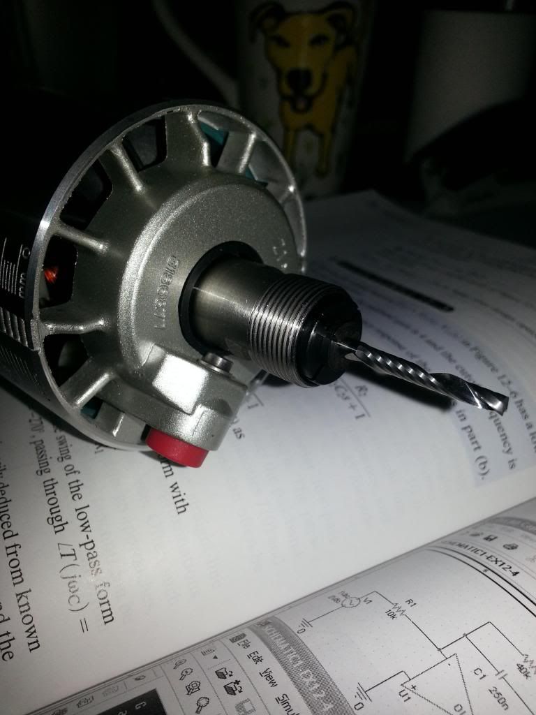

So I called Makita about the 763626-6 collet that they use in various other tools to esquire if it would work in the RT0700 and they were unable to tell me if it would or not and did not have access to the dimensions. I think that they should have access to that information which disappointed me, but I had another option. I had the local hardware store order one and then compared it to the stock 1/4 inch collet and they are way different. It is way too small to work in the RT0700 if anyone else finds it and is wondering.

The Makita 763626-6 collet does not work with the RT0700C. I bought one: it's a lot smaller than what the RT0700C needs.

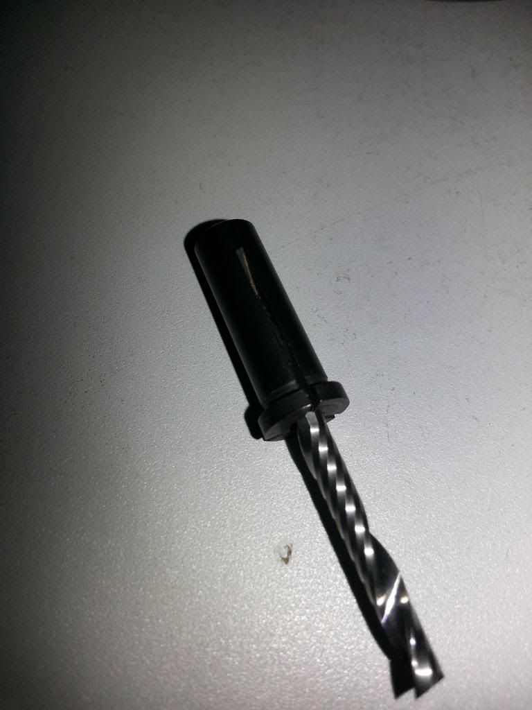

I found this little collet adapter on amazon and figured I would give it a shot. It seems solid, well made and when I put it on I could see no apprediable increase in run-out. It looked actually a little less than the run-out I was seeing previously but I was measuring two different end mills (a 1/4 shank with the stock collet and a 1/8 now with the reducer) so I assume that would affect the results. Also my dial indicator is not that great, so I am going to borrow one from work next week when I have everything all set up.

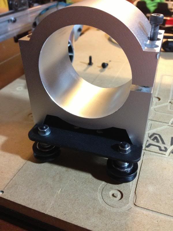

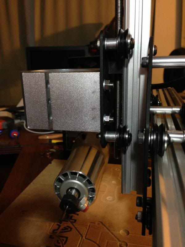

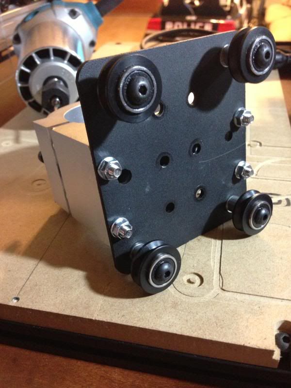

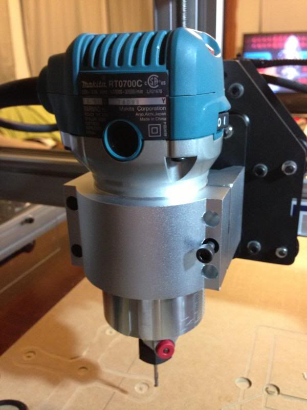

Here is my Makita mounted with the 65mm spindle mount from eBay (purchased from goodlucksell for $24 shipped!)
This trim router seems quite powerful & I cant wait to finally cut something with it, especially with the built in speed control. The mount is very solid and I had to drill new holes in the mounting plate. The mount only came with 4 long M5 fasteners, & I used M5 nuts & washers I had previously purchased from Inventables.
The mount did not come with a bolt for clamping down on the router either, but was also an M5 thread. What I ended up doing was recycling one of the stock spindle mounting bolts, threaded a nut & tightened it down with thread locker, then using a drill & file I rounded down the nut to create a stepped fastener as pictured. This is now my clamping bolt.
You will notice that the mount looks cast & not milled, while the pictures of the item being sold on eBay are clearly a milled part. Does this matter? Probably not because this mount is ridiculously stout and took more effort than it should have to clamp down the spindle. If you look close in the pics the mount does have a few dings, which tells me the aluminum is pretty soft, but it took some effort to get the spindle clamped down with only a single bolt
& here are a few more pics of how I mounted the mount.
I think I have my machine setup and aligned pretty well, almost ready to crank out a test cut, but today I tested the Z axis & found it was not missing any steps while moving this large router. Setting it on the bed & doing a straight 2" climb followed by a 2" drop, after multiple times the bit stopped right at the bed, not higher or ever hitting the bed, telling me that it lost zero steps in the countless 2" movements.

Wow that thing's beefy! Enough room for the delrin nut behind it?
Audiophyle
Posts: 35
Joined: Mon Jan 06, 2014 4:34 am
Re: DEWALT DWP611 VS MAKITA RT0700CX
Post by Audiophyle » Tue Feb 25, 2014 6:09 am
I positioned the mount low on the spindle mounting plate & used the higher holes to secure the delrin nut, that way I can now undo the 2 bolts from the delrin nut & the Z assembly will drop right off. But not too low on the mount so I can still use the eccentric nut to adjust the V wheels. It fit almost perfectly.
