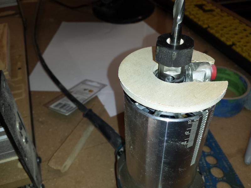

Cant stand it blowing chips everywhere!
My fix! LOL

As far as I can tell that blowing not only helps keep the chips out of the path of the bit it also helps keep the bit cool for longer tool life.. I could be wrong would not be the first time wont be the last.

Well, I made a dust container for mine. WillAdams has a really slick one where it's all clear so you can see the bit while it's cutting.
The dust container keeps the air from the router away from the cut material, while the vacuum creates incoming air and evacuates the dust.

Damin69 wrote:As far as I can tell that blowing not only helps keep the chips out of the path of the bit it also helps keep the bit cool for longer tool life.. I could be wrong would not be the first time wont be the last.
Yes, the dust is blown out of the path, directly into everyone's shops and lungs.
I use the custom 3D printed dust shoe. It works well cause it vents the air directly out (perpendicular to the bit), but still allows a vacuum to collect dust and chips.
http://www.shapeoko.com/forum/viewtopic ... 019#p30087
However I do like the OP's idea! I wish I had thought of it sooner!

Wish I had a 3d printer. I would love one of those. I was having problems with cutting wood. It would blow the chips everywhere! My Z axis even started to have problems moving up and down because of all of it. Im looking into a dush shoe setup.
